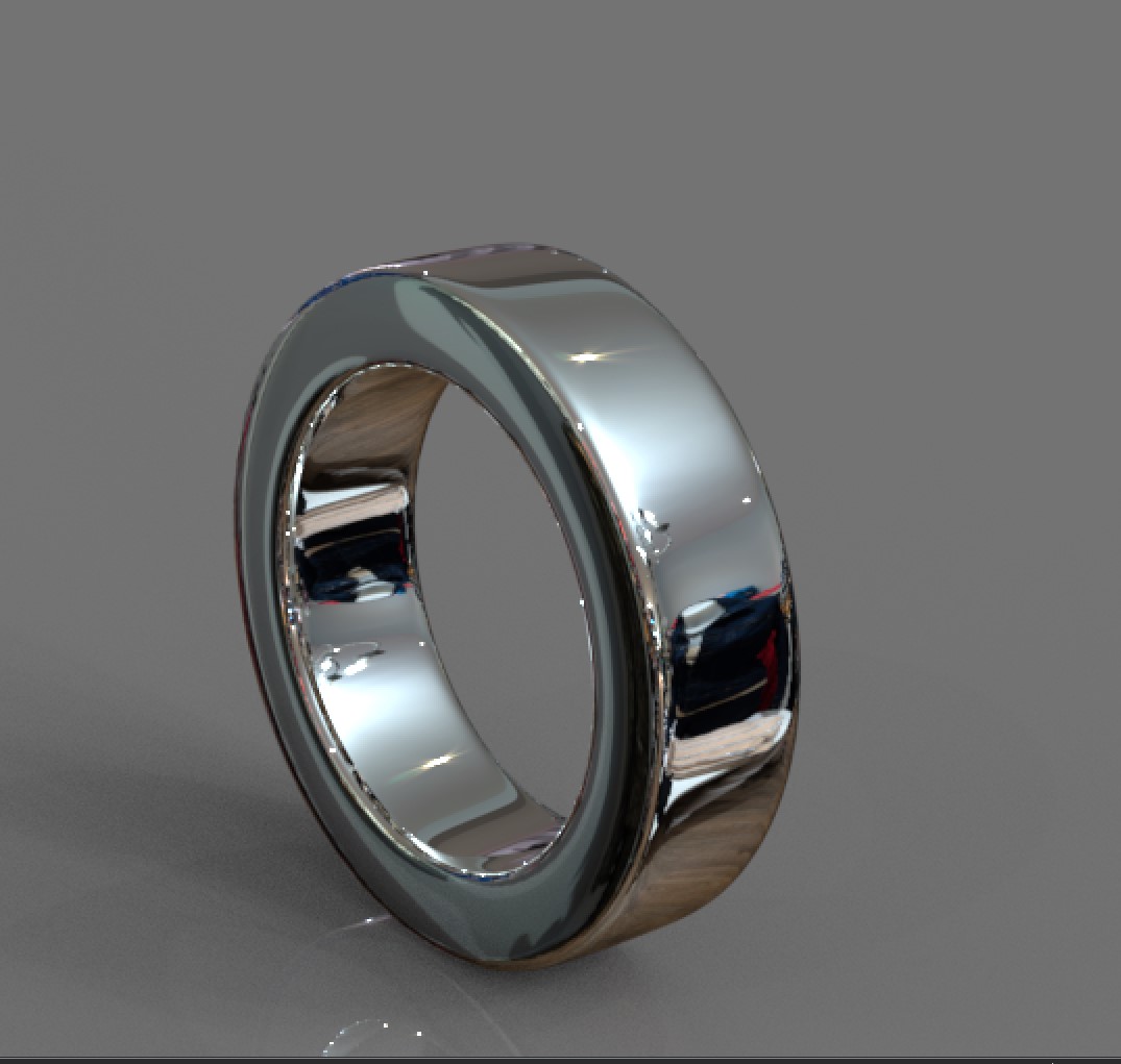

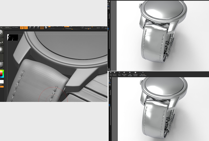

OK. I made this simple, super smooth band, and there are no mangle angles and so forth. But the result is the same. Jagged render and is not even soft on the viewer either. How can that possibly be? Please render this model in gold using an environment etc… Thank you very much
If you click on this render and zoom in a little you’ll see that the jagged lines

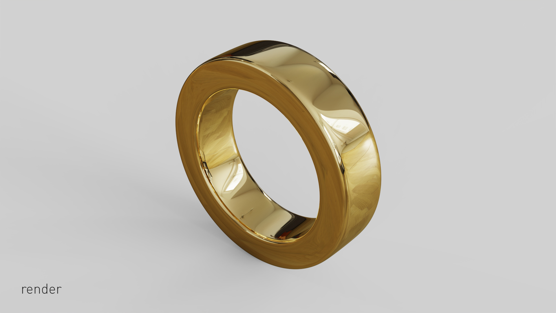

This looks indeed again to some low resolution render like you’ve zoomed in the result twice.

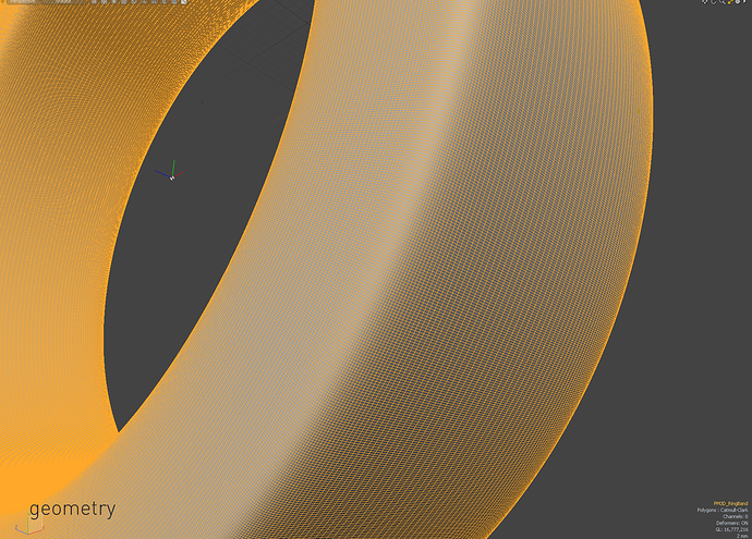

The geometry is perfectly fine although way way more polygons than needed for such a shape but the edges are nice and the edges follow the shape.

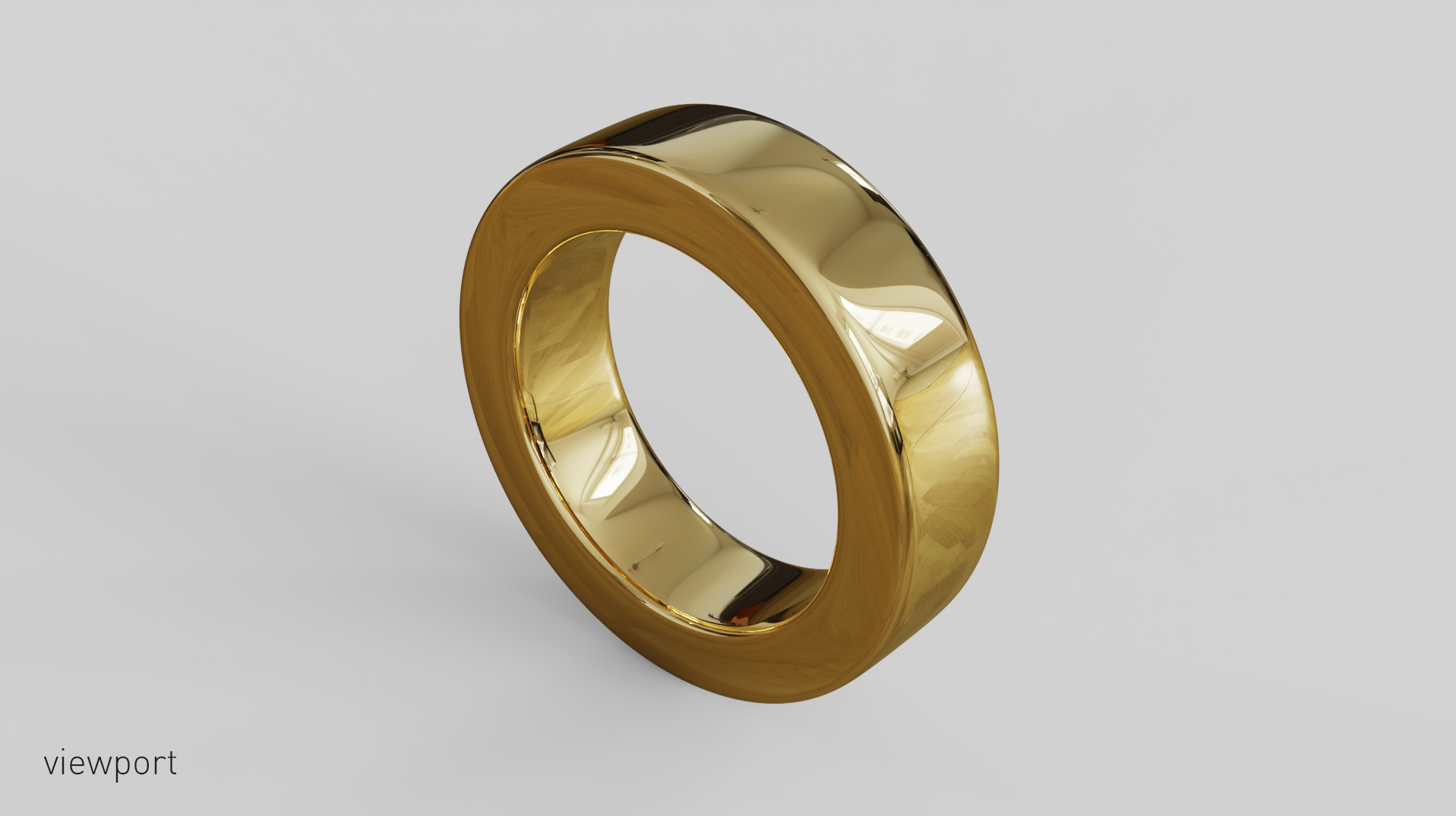

In the viewport it also looks really smooth. I used some appartement interior HDRI.
And the render also looks perfectly fine. The whites are less bright but that’s because I put it on ‘photography’ instead of ‘Basic’.
So with this model and KS is nothing wrong. I wanted to pack the Keyshot file but than I remembered you can’t open newer files in older KeyShots. I’m not sure which version you have next to the bridge else I can try to find the old one and install it just to get you a KS file to check for yourself.

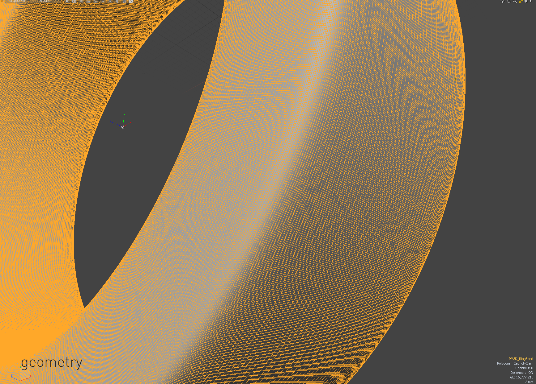

Back to the topic, I see problems in the topology of the upper ring parts, I quickly recreated them in ZB and upload them as ZTL and sometimes as obj for ZB, maybe that will help!
ZBrush-ScreenGrab01b|278x500
https://drive.google.com/drive/folders/1sVWJNCEmftCzKjhLiD6SpTnAEPqYJrZk?usp=sharing

My problem was that my model done in ZBrush didn’t have correct normals. I tried the Edit Normals in KeyShot to fix it (mentioned by Oscar above) and that fixes it I think. So nothing wrong with the bridgeing for me. Apparently I am no ZBrush master since I don’t know where to fix it in ZBrush : )

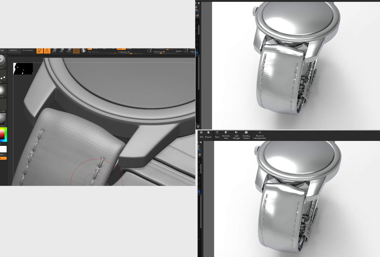

Yes. I also regret updating from 10 to 10.2 bk that is when things went wrong. The bridge works fine, but I noted several inconsistencies in the program works. The first unacceptable problem is that the rendering is crappy, jagged, and low res no matter how good the models are. The UI looks clunky, and the thumb pictures are in low res ( a minor problem). Also, it sounds like my computer is struggling to keep up with KS, and that is strange since I have a super-powerful computer.
